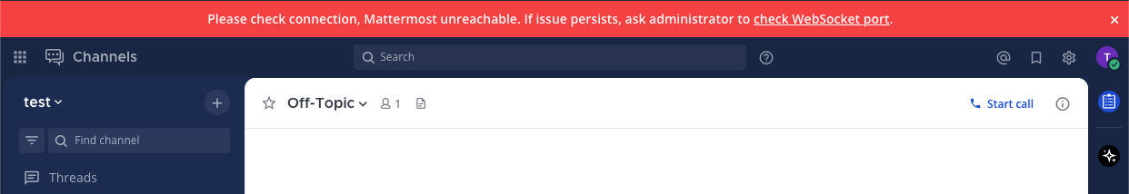

Symptoms
Users experiencing this issue will see:
Please check connection, Mattermost unreachable. If issue persists, ask administrator to check WebSocket port.

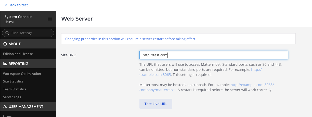

Verify Site URL Configuration
Ensure that your Site URL is correctly configured in your Mattermost configuration:
"ServiceSettings": {
  "SiteURL": "https://your-mattermost-domain.com"
The Site URL should match the primary domain users use to access Mattermost.

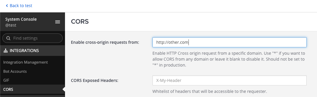

Configure CORS Settings
Add the AllowCorsFrom setting to allow WebSocket connections from additional origins:
  "SiteURL": "https://your-mattermost-domain.com",
  "AllowCorsFrom": "https://alternative-domain.com https://another-domain.com"
Important: Replace the example domains with the actual domains your users access Mattermost from. Multiple domains should be separated by spaces.
