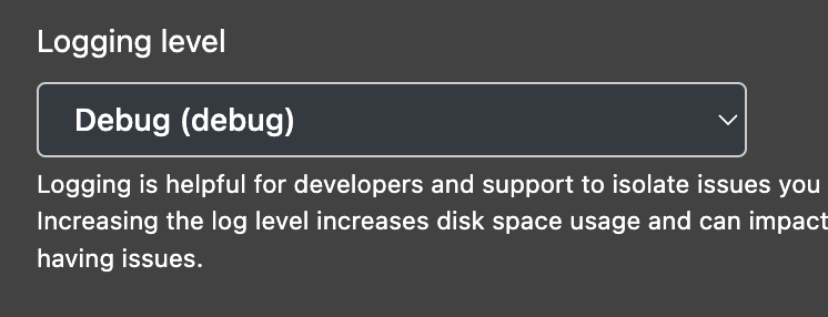

  2. Enable Debug Logging
    • In the Settings modal, scroll down to the Logging Level section.
    • Change the logging level to Debug.
    Debug logging setting
