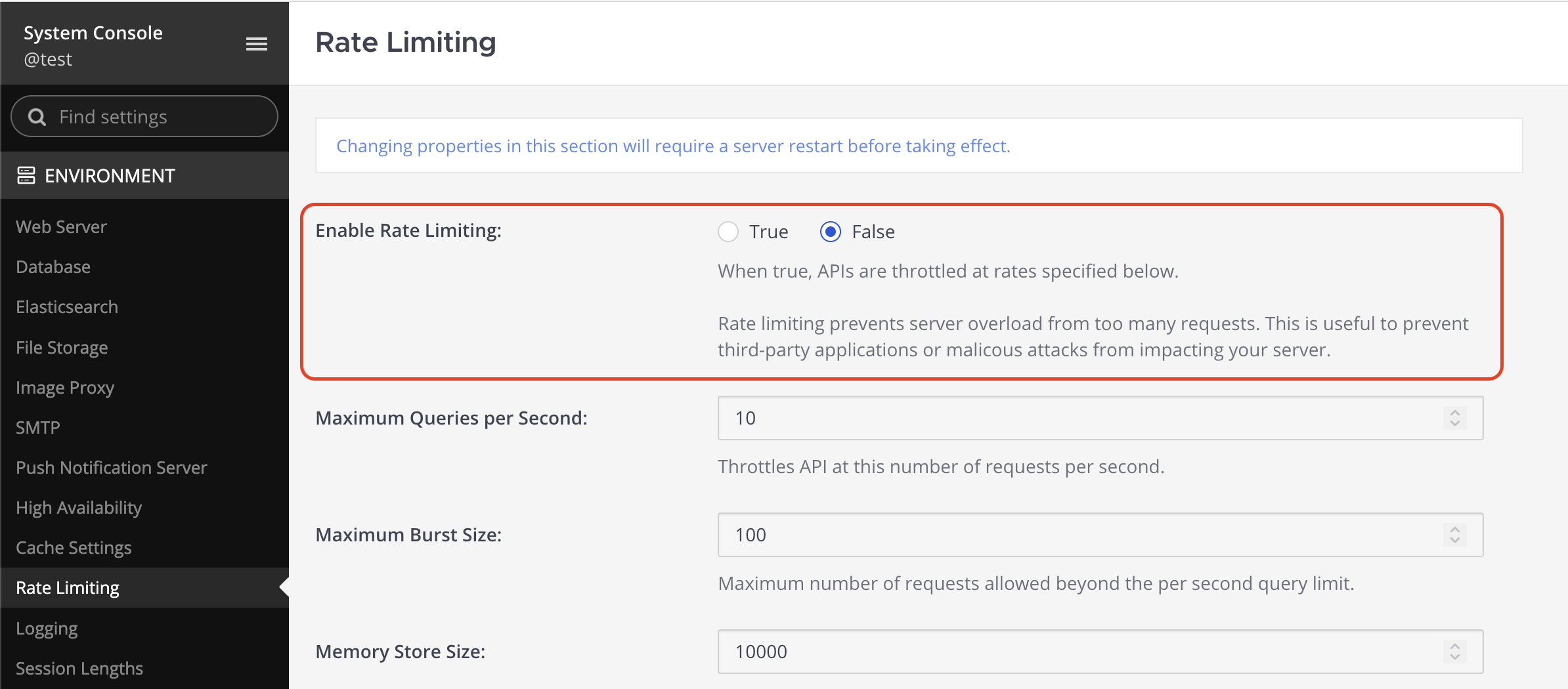

Option 3: System Console Method
Navigate to System Console → Environment → Rate Limiting and set Enable Rate Limiting to False.
After making any of these changes, restart your Mattermost server for the configuration to take effect.
